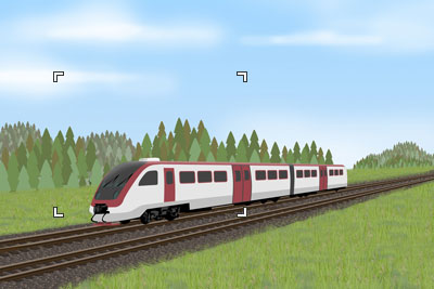

To find a car/train or airplane from as wide a range as possible, set [Focus Area] to [Wide] to recognize and focus on a specific part or all of a car/train or airplane within the focusing area.
If you want to limit the range in which a car/train or airplane is detected, set [Focus Area] to parameters such as [Spot] or [Zone] in advance.

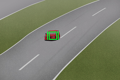

When [Focus Area] is set to [Zone]
Recognition Target]: [Car/Train]
Recognition Target]: [Airplane]

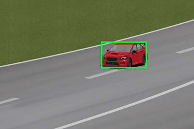

Press the shutter button halfway down to focus.*
When the camera recognizes and focuses on a car, a green recognition frame appears around the entire car, the front of the car, or the driver’s helmet.
When the camera recognizes a train and focuses on that train, a green subject-recognition frame appears on the entire portion or front of the train, or the driver seat window.
When the camera recognizes an airplane or helicopter and focuses on it, a green subject-recognition frame appears on the aircraft or its nose.* You can also focus by pressing the custom key to which [AF On] is assigned.
