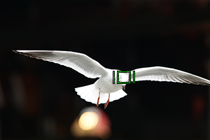

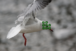

    Example of primarily using [Expand Spot], combined with a wide focus area for more versatile use
    • [Focus Area]: [Expand Spot]
    • AF-ON button: Assign [Tracking: Expand Spot].
    • AEL button: Assign [Wide].

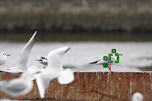

    A: Focusing on a subject while avoiding obstacles in the foreground
    A
    B: Tracking subjects that move at random speeds
    B
    C: Shooting a subject that comes into the frame suddenly
    C
    This is an example of combining [Expand Spot] with [Wide]. When you aim at a certain bird in the flock, use [Expand Spot] (A). When the target bird is moving, use [Tracking: Expand Spot] with the AF-ON button (B). You can switch the focus area to [Wide] instantly by pressing the AEL button even if flying birds come into the frame suddenly (C).

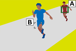

    Displaying the tracking start area during tracking and making it easy to capture a subject when you start shooting with auto focus again ([Area Disp. dur Tracking])
    This function enables you to display the frame indicating the focusing area from where tracking was started, even during tracking. When you want to switch the subject being tracked to another subject, you can capture the new subject quickly since the frame indicating the focusing area is displayed in advance.
    Advance preparation
    1. Set the Still/Movie/S&Q dial to (Still) to select the still image shooting mode.
    2. [Focus Mode]: [Continuous AF]
    3. MENU → (Focus) → [Focus Area] → [Focus Area] → [Tracking] (excepting [Tracking: Wide])
    4. MENU → (Focus) → [Focus Area] → [Area Disp. dur Tracking] → [On]
    Shooting
    Tracking Subject “A” was started using the tracking function. Both the tracking frame and tracking start area are displayed on Subject “A.”
    The tracking frame follows Subject “A,” but the tracking start area remains at the starting position.
    When you want to stop tracking a subject and switch focus from one subject to another, you can capture the new subject quickly since you already know the tracking start area in advance.
    * This function can be used together with the [Track Recog Off on Hold] function, which can be used to pause the tracking function.
