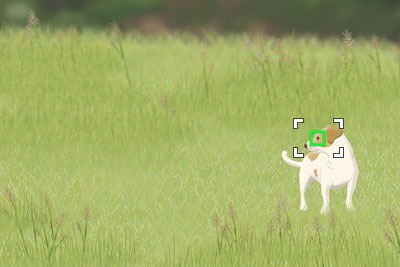

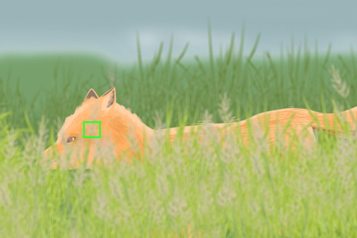

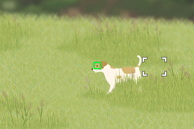

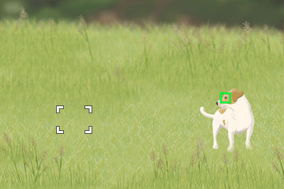

    1. Point the camera so that the animal’s eye to be focused on are within the focus area.
      When [Focus Area] is set to [Tracking: Zone]

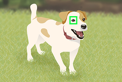

    2. Press the shutter button halfway down to focus.*
      When the camera recognizes the eye of an animal and focuses on it, a green subject recognition frame appears around the subject’s eye, etc.

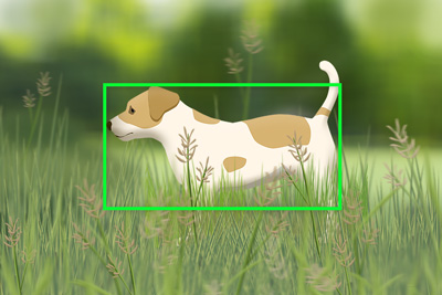

    When [Subject Recog in AF] is set to [On], the focus frame will automatically move to a recognized part of a subject if the part, such as an eye, is detected while the subject is being tracked using the tracking function.
    The camera automatically selects the part (in the order of eye, head, and body) to focus on with priority. If the camera cannot focus on the body, it starts tracking.

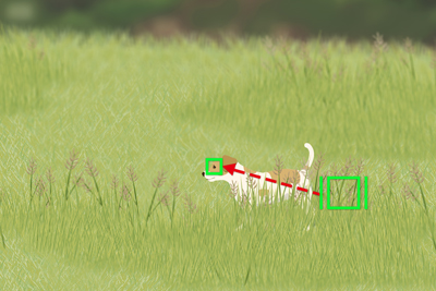

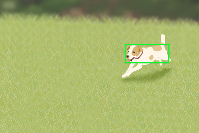

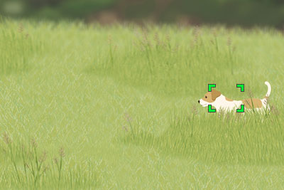

    The following procedure is used under the condition where [Recognition Target] is set to [Animal], and [Recognition Part] is set to [Eye/Head/Body].

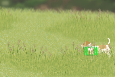

    1. Tracking distant subjects
    2. The body of a subject is recognized when the subject being tracked is getting closer.
    3. An eye of a subject is recognized when the subject being tracked is getting even more closer.
    4. If the camera cannot recognize an eye because the subject is turned away, the camera will recognize the head or body.

    Example of a subject with a hard-to-recognize eye

    Example of a subject that has a hard-to-recognize head or body

    A part of the body is hidden.
